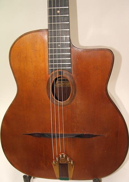

Hmmmm, how about a picture, everybody likes pictures.
You can get this one for $26,500. 1946 serial #625.
